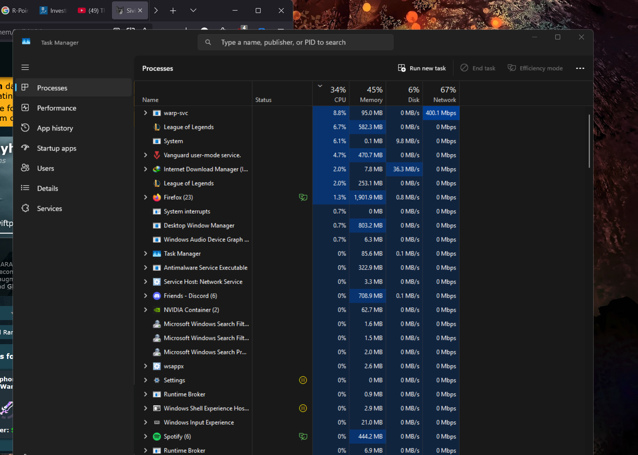

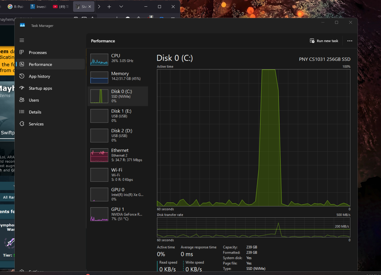

      Thank you. I will report back when I see the spikes, usually what happens is the spikes don't last long. The spikes happen and go away immediately, I have checked my processes during those moments and everything is usually normal (or I can't remember a high usage.).
      I checked with emisoft and it shows no detection for both quick scan and malware scan.
      Attached is how the spike is like in my system. Happens and then stays calm immediately.

          Click image for larger version
          there was no warning in event viewer at that time. this was right after I closed league of legend game and went into its client.

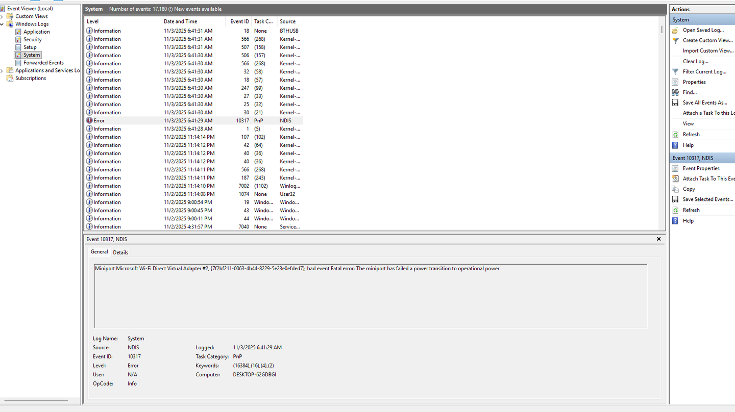

                In eventviewer, I did find an error in system subsection of windows logs at the time of the gray screen.
                Click image for larger version  Name:	image.png Views:	0 Size:	341.7 KB ID:	205566

                  The Event Viewer entry shows:
                  Source: NDIS
                  Event ID: 10317
                  Description: "Miniport Microsoft Wi-Fi Direct Virtual Adapter #2 had event Fatal error: The miniport has failed a power transition to operational power."
                  This error relates to your Wi-Fi adapter’s power management rather than the display or Windows Explorer. It usually occurs when the adapter fails to wake up properly from sleep or hibernation.

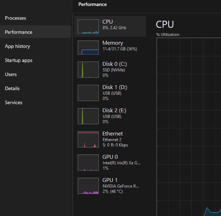

                  There are some random spikes, and I usually see System process in the Processes tab of task manager in the top according to the disk usage. But it is not common and only happens once or twice a day.
